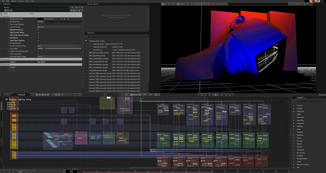

“When we started to narrow down ideas, Notch became a useful way of visualising different screen and projection setups, and surface treatments. We were rendering pre-vis animations rapidly and using them in presentations and pitches during the early development of IICON.”

“AV:3D was a very complex edit by Dylan Byrne, using massive amounts of footage combined with bespoke 3D particle systems which I made in Notch. Using Notch and NDI Dylan could edit everything on a standard UV layout in Premiere Pro and After Effects, and stream that to the head model.”
“I made other UV setups that allowed for different perspective mappings, the most complex of which used pre-comped layers that had three perspective mapped cameras combined into the standard UV template output. We used this whenever rendering anything that didn’t work directly as a render to UV.”
